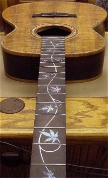

Lance I radius and slot first so that I sand the least amount of pearl as possible. I also prefer to plan my inlays so that there are breaks in the pattern at the fret slots. This means more pieces to cut and inlay. but hay,....... I have always been a glutten for punishment... I started this after I inlayed flat and before sloting one time and had several pieces of super indigo blue paua crack and flake into pieces when slotting. So now I go to the extra trouble of plannin he breaks to keep this from happening. Here is a photo example of the planed breaks...

Lance I radius and slot first so that I sand the least amount of pearl as possible. I also prefer to plan my inlays so that there are breaks in the pattern at the fret slots. This means more pieces to cut and inlay. but hay,....... I have always been a glutten for punishment... I started this after I inlayed flat and before sloting one time and had several pieces of super indigo blue paua crack and flake into pieces when slotting. So now I go to the extra trouble of planning the breaks to keep this from happening. Here is a photo example of the planed breaks...
PostPosted: Thu Dec 30, 2004 1:34 am
Beautiful work Michael. I just can't see any reason to plan all thos slot breaks. Seems easier to just cut them when it's done. That's just me I guess

Michael, What ARE those leaves? Not only are they lovely, but they look slightly illegal

Like I said, I once had some paua litraly shatter, and it is almost impossible to re-cut to match the routed cavity on intracate inlays. most of the time I will cut the pattern full and cut the breaks after all basic shape cutting is done. this only take a few extra min's.
PostPosted: Thu Dec 30, 2004 1:41 am
No-No they are japanese Maple leaves not pot leaves...
PostPosted: Thu Dec 30, 2004 1:43 am
Um, ya -- OK

Here is the whole neck
PostPosted: Thu Dec 30, 2004 1:54 am
Dang ! thats killer!

The whole guitar looks really beautiful Michael. The vine somehow really works well with the Koa. That is Koa isn't it?

thought I had posted this but I guess not here is a pic of the full neck
PostPosted: Thu Dec 30, 2004 2:11 am
sure now it showes up

it is a extremly curly piece of Koa. I got it from Steve at Colonial. If you are a finger style player you really want to try a RW/Koa toped Om. It has the most incredable warm tone of any guitar i have ever played more less built.
